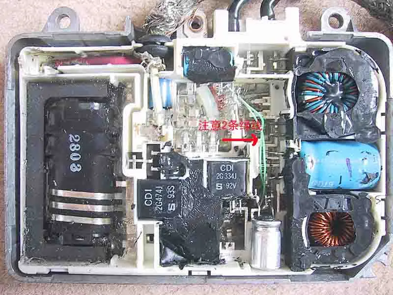

你见过吗?最新HID EB!
500) {this.resized=true; this.width=500; this.alt='这是一张缩略图,点击可放大。\n按住CTRL,滚动鼠标滚轮可自由缩放';this.style.cursor='hand'}" onclick="if(!this.resized) {return true;} else {window.open('http://u.dianyuan.com/bbs/u/31/1121476946.jpg?x-oss-process=image/watermark,g_center,image_YXJ0aWNsZS9wdWJsaWMvd2F0ZXJtYXJrLnBuZz94LW9zcy1wcm9jZXNzPWltYWdlL3Jlc2l6ZSxQXzQwCg,t_20');}" onmousewheel="return imgzoom(this);">500) {this.resized=true; this.width=500; this.alt='这是一张缩略图,点击可放大。\n按住CTRL,滚动鼠标滚轮可自由缩放';this.style.cursor='hand'}" onclick="if(!this.resized) {return true;} else {window.open('http://u.dianyuan.com/bbs/u/31/1121476981.jpg?x-oss-process=image/watermark,g_center,image_YXJ0aWNsZS9wdWJsaWMvd2F0ZXJtYXJrLnBuZz94LW9zcy1wcm9jZXNzPWltYWdlL3Jlc2l6ZSxQXzQwCg,t_20');}" onmousewheel="return imgzoom(this);">

兄弟,可能你对HID刚刚入手吧?这是日本电装(DENSO)给丰田用的安定器,不过已经是好几年前的了吧.我手上有跳线升到50W输出的方法.呵呵

再发一个-hella500) {this.resized=true; this.width=500; this.alt='这是一张缩略图,点击可放大。\n按住CTRL,滚动鼠标滚轮可自由缩放';this.style.cursor='hand'}" onclick="if(!this.resized) {return true;} else {window.open('http://u.dianyuan.com/bbs/u/31/1121507003.jpg');}" onmousewheel="return imgzoom(this);">

感谢hid988兄弟,你贴的图我都没见过,真是大开眼界!

再发一个PHILIPS的.500) {this.resized=true; this.width=500; this.alt='这是一张缩略图,点击可放大。\n按住CTRL,滚动鼠标滚轮可自由缩放';this.style.cursor='hand'}" onclick="if(!this.resized) {return true;} else {window.open('http://u.dianyuan.com/bbs/u/31/1121658488.jpg');}" onmousewheel="return imgzoom(this);">

继续!500) {this.resized=true; this.width=500; this.alt='这是一张缩略图,点击可放大。\n按住CTRL,滚动鼠标滚轮可自由缩放';this.style.cursor='hand'}" onclick="if(!this.resized) {return true;} else {window.open('http://u.dianyuan.com/bbs/u/31/1121658592.jpg');}" onmousewheel="return imgzoom(this);">

能否再贴几张Hella的?
hella pic500) {this.resized=true; this.width=500; this.alt='这是一张缩略图,点击可放大。\n按住CTRL,滚动鼠标滚轮可自由缩放';this.style.cursor='hand'}" onclick="if(!this.resized) {return true;} else {window.open('http://u.dianyuan.com/bbs/u/31/1121730306.jpg');}" onmousewheel="return imgzoom(this);">

上图中Hella的只用几颗镙丝固定, 不知如何保证密封的?

请问这个HELLA的EB是什么型号(PART NUMBER)? 您在哪里买来的? 我想去买一个.

请问你从基板背面能看见DC-DC变压器的次级是用什么做的吗?我非常感兴趣!请你务必给我一个回复!谢谢

海拉的主电路是采用什么结构的?请赐教...
Hella 3型HID镇流器采用单端反激式DC-DC变换器,PWM和PFM复合式控制方式.这种控制方式要求控制器有很高的响应速度和很宽的变频范围.它的PWM工作频率能根据需要迅速的从开机时的一百多KHz 变到只有几KHz;当氙灯击穿后又能迅速的变化到近300KHz;它的PWM占空比能小到8%,大到89%.当外界工况变化时,它能在几个微妙内实现闭环控制,迅速改变PWM的占空比同时改变PWM的工作频率.所以它的单端反激式DC-DC变换器的初级和次级波形几乎做到了完美无缺的地步!(接近方波,单端反激式变换器特有的上升沿过冲几乎看不见!)是我所分析过的十余种HID镇流器中唯一无可挑剔的!这一切都是受控于那块专门设计的ASIC.目前还没有一家公司能超过Hella 的技术水平.

请问HELLA的4型主电路是什么结构?

抗干扰做的真不错
