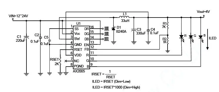

2008-07-28 10:12
AX2005-1.2A 3-channel RGB LED driver with Dimming
AX2005 datasheet: 24511217211002.pdf
0755-83991588  sales@micro-bridge.com
500) {this.resized=true; this.width=500; this.alt='这是一张缩略图,点击可放大。\n按住CTRL,滚动鼠标滚轮可自由缩放';this.style.cursor='hand'}" onclick="if(!this.resized) {return true;} else {window.open('http://u.dianyuan.com/bbs/u/67/24511217211160.jpg');}" onmousewheel="return imgzoom(this);">
