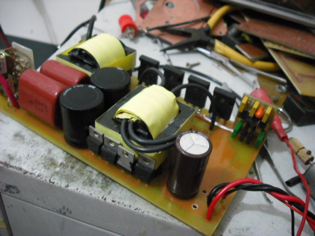

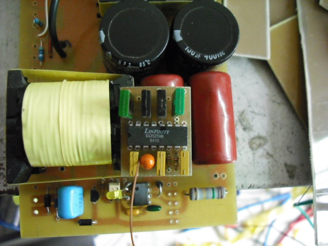

前级推动板
500) {this.resized=true; this.width=500; this.alt='这是一张缩略图,点击可放大。\n按住CTRL,滚动鼠标滚轮可自由缩放';this.style.cursor='hand'}" onclick="if(!this.resized) {return true;} else {window.open('http://u.dianyuan.com/bbs/u/82/2977471255974924.jpg');}" onmousewheel="return imgzoom(this);">
后级特写
500) {this.resized=true; this.width=500; this.alt='这是一张缩略图,点击可放大。\n按住CTRL,滚动鼠标滚轮可自由缩放';this.style.cursor='hand'}" onclick="if(!this.resized) {return true;} else {window.open('http://u.dianyuan.com/bbs/u/82/2977471255975035.jpg');}" onmousewheel="return imgzoom(this);">
后级特写

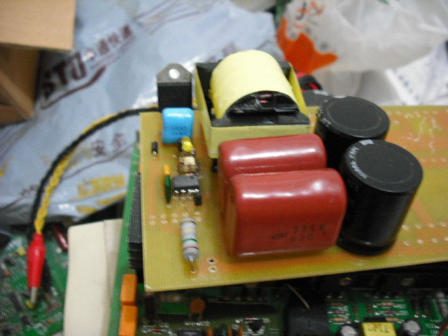

前级推动板[图片]500){this.resized=true;this.width=500;this.alt='这是一张缩略图,点击可放大。\n按住CTRL,滚动鼠标滚轮可自由缩放';this.style.cursor='hand'}"onclick="if(!this.resized){returntrue;}else{window.open('http://u.dianyuan.com/bbs/u/82/2977471255974924.jpg');}"onmousewheel="returnimgzoom(this);">后级特写[图片]500){this.resized=true;this.width=500;this.alt='这是一张缩略图,点击可放大。\n按住CTRL,滚动鼠标滚轮可自由缩放';this.style.cursor='hand'}"onclick="if(!this.resized){returntrue;}else{window.open('http://u.dianyuan.com/bbs/u/82/2977471255975035.jpg');}"onmousewheel="returnimgzoom(this);">

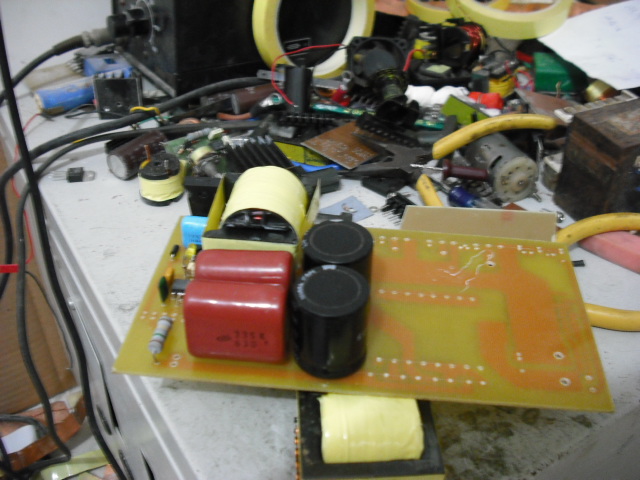

把前级板安装上
500) {this.resized=true; this.width=500; this.alt='这是一张缩略图,点击可放大。\n按住CTRL,滚动鼠标滚轮可自由缩放';this.style.cursor='hand'}" onclick="if(!this.resized) {return true;} else {window.open('http://u.dianyuan.com/bbs/u/82/2977471255975280.jpg');}" onmousewheel="return imgzoom(this);">

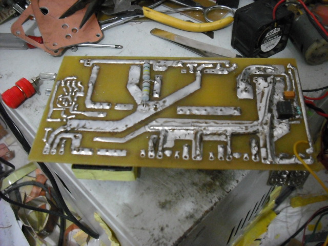

电路板背面(焊锡已熔化焊好,不过有松香在上面不好看,也懒得洗板)
500) {this.resized=true; this.width=500; this.alt='这是一张缩略图,点击可放大。\n按住CTRL,滚动鼠标滚轮可自由缩放';this.style.cursor='hand'}" onclick="if(!this.resized) {return true;} else {window.open('http://u.dianyuan.com/bbs/u/82/2977471255975504.jpg');}" onmousewheel="return imgzoom(this);">

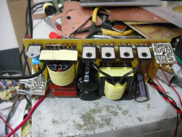

把4个IRFP2907功率管和可控硅装上
500) {this.resized=true; this.width=500; this.alt='这是一张缩略图,点击可放大。\n按住CTRL,滚动鼠标滚轮可自由缩放';this.style.cursor='hand'}" onclick="if(!this.resized) {return true;} else {window.open('http://u.dianyuan.com/bbs/u/82/2977471255975573.jpg');}" onmousewheel="return imgzoom(this);">
500) {this.resized=true; this.width=500; this.alt='这是一张缩略图,点击可放大。\n按住CTRL,滚动鼠标滚轮可自由缩放';this.style.cursor='hand'}" onclick="if(!this.resized) {return true;} else {window.open('http://u.dianyuan.com/bbs/u/82/2977471255975642.jpg');}" onmousewheel="return imgzoom(this);">
4个RHRP8120桥式整流(可惜排版不够好看,以后再排过)
500) {this.resized=true; this.width=500; this.alt='这是一张缩略图,点击可放大。\n按住CTRL,滚动鼠标滚轮可自由缩放';this.style.cursor='hand'}" onclick="if(!this.resized) {return true;} else {window.open('http://u.dianyuan.com/bbs/u/82/2977471255975835.jpg');}" onmousewheel="return imgzoom(this);">

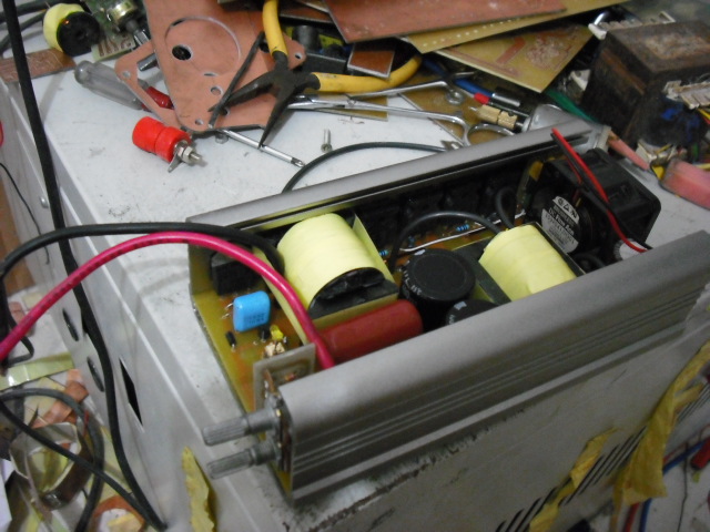

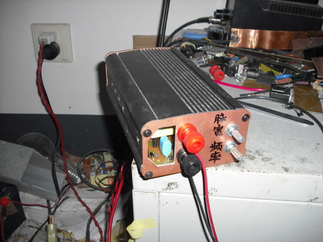

把电路板装入机壳
500) {this.resized=true; this.width=500; this.alt='这是一张缩略图,点击可放大。\n按住CTRL,滚动鼠标滚轮可自由缩放';this.style.cursor='hand'}" onclick="if(!this.resized) {return true;} else {window.open('http://u.dianyuan.com/bbs/u/82/2977471255975971.jpg');}" onmousewheel="return imgzoom(this);">
把两边盖装上
500) {this.resized=true; this.width=500; this.alt='这是一张缩略图,点击可放大。\n按住CTRL,滚动鼠标滚轮可自由缩放';this.style.cursor='hand'}" onclick="if(!this.resized) {return true;} else {window.open('http://u.dianyuan.com/bbs/u/82/2977471255976132.jpg');}" onmousewheel="return imgzoom(this);">
500) {this.resized=true; this.width=500; this.alt='这是一张缩略图,点击可放大。\n按住CTRL,滚动鼠标滚轮可自由缩放';this.style.cursor='hand'}" onclick="if(!this.resized) {return true;} else {window.open('http://u.dianyuan.com/bbs/u/82/2977471255976157.jpg');}" onmousewheel="return imgzoom(this);">
OK,到止整机已安装完毕.明天再上调试方法

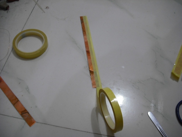

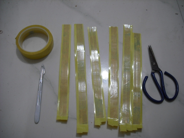

裁剪铜皮500) {this.resized=true; this.width=500; this.alt='这是一张缩略图,点击可放大。\n按住CTRL,滚动鼠标滚轮可自由缩放';this.style.cursor='hand'}">
铜皮绝缘,用马拉胶正反两面都粘平

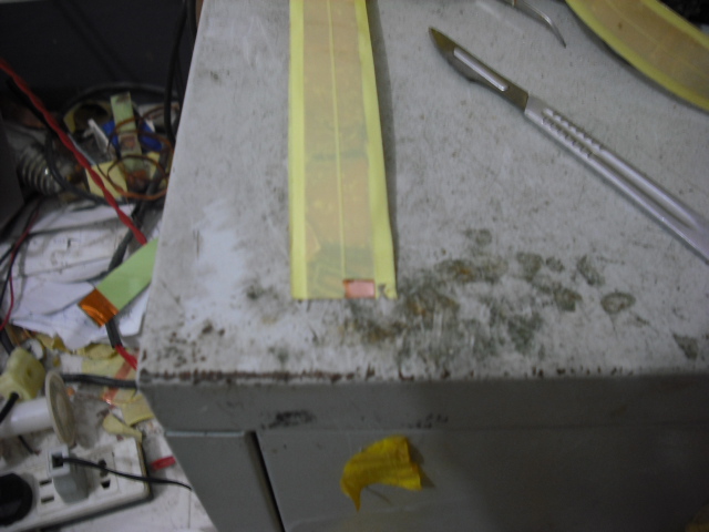

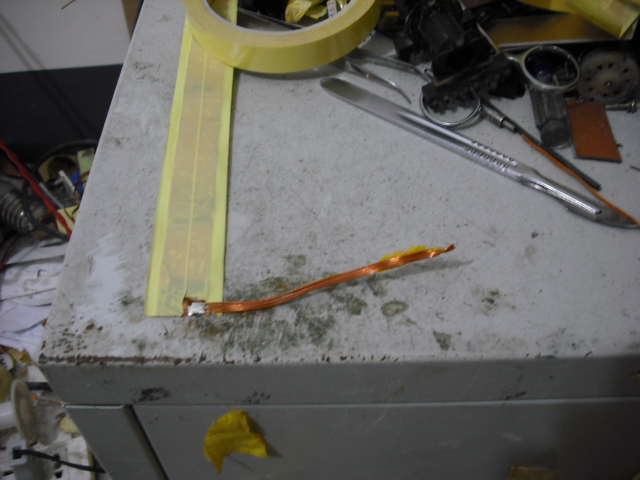

500) {this.resized=true; this.width=500; this.alt='这是一张缩略图,点击可放大。\n按住CTRL,滚动鼠标滚轮可自由缩放';this.style.cursor='hand'}">500) {this.resized=true; this.width=500; this.alt='这是一张缩略图,点击可放大。\n按住CTRL,滚动鼠标滚轮可自由缩放';this.style.cursor='hand'}">
铜皮引线制作

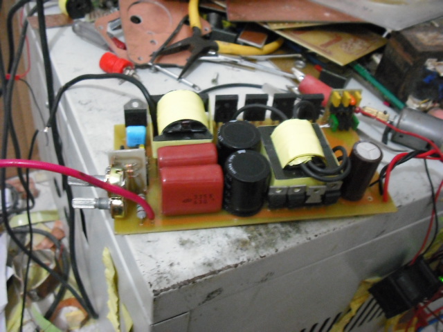

鱼机的调试
刚开始接电时,找一个30~50W\12V的变压器整流或有过流保护的稳压电源或是在电源里串一个12V\35W的灯泡,这是试机时减少烧东西的一个重要手段,很多新手都忽略这点.看机子能够正常起振,电流不是很大后可以直接接电瓶来试机了.这是我试机用的变压器

鱼机的调试刚开始接电时,找一个30~50W\12V的变压器整流或有过流保护的稳压电源或是在电源里串一个12V\35W的灯泡,这是试机时减少烧东西的一个重要手段,很多新手都忽略这点.看机子能够正常起振,电流不是很大后可以直接接电瓶来试机了.这是我试机用的变压器[图片]500){this.resized=true;this.width=500;this.alt='这是一张缩略图,点击可放大。\n按住CTRL,滚动鼠标滚轮可自由缩放';this.style.cursor='hand'}"onclick="if(!this.resized){returntrue;}else{window.open('http://u.dianyuan.com/bbs/u/82/2977471256011533.jpg');}"onmousewheel="returnimgzoom(this);">负载是500W灯泡[图片]500){this.resized=true;this.width=500;this.alt='这是一张缩略图,点击可放大。\n按住CTRL,滚动鼠标滚轮可自由缩放';this.style.cursor='hand'}"onclick="if(!this.resized){returntrue;}else{window.open('http://u.dianyuan.com/bbs/u/82/2977471256011659.jpg');}"onmousewheel="returnimgzoom(this);">
两个电位器调到最小时的电流
500) {this.resized=true; this.width=500; this.alt='这是一张缩略图,点击可放大。\n按住CTRL,滚动鼠标滚轮可自由缩放';this.style.cursor='hand'}" onclick="if(!this.resized) {return true;} else {window.open('http://u.dianyuan.com/bbs/u/82/2977471256011839.jpg');}" onmousewheel="return imgzoom(this);">
调到最佳工作电流范围,低压电源线暖手
500) {this.resized=true; this.width=500; this.alt='这是一张缩略图,点击可放大。\n按住CTRL,滚动鼠标滚轮可自由缩放';this.style.cursor='hand'}" onclick="if(!this.resized) {return true;} else {window.open('http://u.dianyuan.com/bbs/u/82/2977471256088108.jpg');}" onmousewheel="return imgzoom(this);">
500) {this.resized=true; this.width=500; this.alt='这是一张缩略图,点击可放大。\n按住CTRL,滚动鼠标滚轮可自由缩放';this.style.cursor='hand'}" onclick="if(!this.resized) {return true;} else {window.open('http://u.dianyuan.com/bbs/u/82/2977471256012577.jpg');}" onmousewheel="return imgzoom(this);">
取最大工作电流范围
500) {this.resized=true; this.width=500; this.alt='这是一张缩略图,点击可放大。\n按住CTRL,滚动鼠标滚轮可自由缩放';this.style.cursor='hand'}" onclick="if(!this.resized) {return true;} else {window.open('http://u.dianyuan.com/bbs/u/82/2977471256012103.jpg');}" onmousewheel="return imgzoom(this);">
500) {this.resized=true; this.width=500; this.alt='这是一张缩略图,点击可放大。\n按住CTRL,滚动鼠标滚轮可自由缩放';this.style.cursor='hand'}" onclick="if(!this.resized) {return true;} else {window.open('http://u.dianyuan.com/bbs/u/82/2977471256012140.jpg');}" onmousewheel="return imgzoom(this);">
因磁芯太小,不敢再调大了,还可以调大,但6平方mm的低压电源线已经烫手,只好到此为止了
