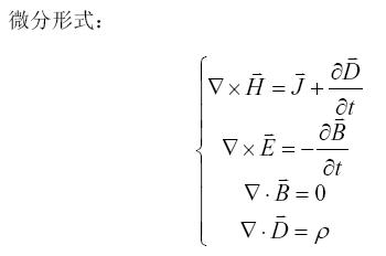

麦克斯韦方程组:
微分形式:
500) {this.resized=true; this.width=500; this.alt='这是一张缩略图,点击可放大。\n按住CTRL,滚动鼠标滚轮可自由缩放';this.style.cursor='hand'}" onclick="if(!this.resized) {return true;} else {window.open('http://u.dianyuan.com/bbs/u/42/1149995887.jpg');}" onmousewheel="return imgzoom(this);">
积分形式:500) {this.resized=true; this.width=500; this.alt='这是一张缩略图,点击可放大。\n按住CTRL,滚动鼠标滚轮可自由缩放';this.style.cursor='hand'}" onclick="if(!this.resized) {return true;} else {window.open('http://u.dianyuan.com/bbs/u/42/1149995925.jpg');}" onmousewheel="return imgzoom(this);">

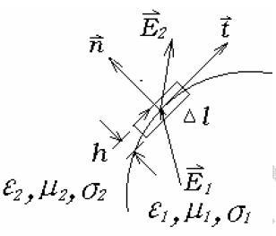

电场强度E的边界条件:nx(E2-E1)=0. 电场强度切向分量连续
500) {this.resized=true; this.width=500; this.alt='这是一张缩略图,点击可放大。\n按住CTRL,滚动鼠标滚轮可自由缩放';this.style.cursor='hand'}" onclick="if(!this.resized) {return true;} else {window.open('http://u.dianyuan.com/bbs/u/42/1150029521.jpg');}" onmousewheel="return imgzoom(this);">

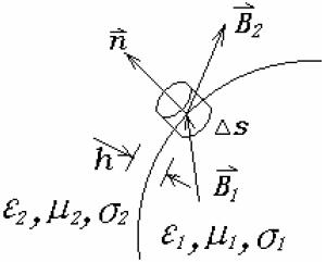

磁感应强度B的边界条件:n.(B2-B1)=0; 磁感应强度的法向分量连续
500) {this.resized=true; this.width=500; this.alt='这是一张缩略图,点击可放大。\n按住CTRL,滚动鼠标滚轮可自由缩放';this.style.cursor='hand'}" onclick="if(!this.resized) {return true;} else {window.open('http://u.dianyuan.com/bbs/u/42/1150032987.jpg');}" onmousewheel="return imgzoom(this);">

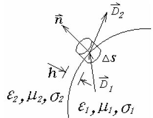

电位移D的边界条件:n.(D2-D1)=ρs; D2n-D1n=ρs
500) {this.resized=true; this.width=500; this.alt='这是一张缩略图,点击可放大。\n按住CTRL,滚动鼠标滚轮可自由缩放';this.style.cursor='hand'}" onclick="if(!this.resized) {return true;} else {window.open('http://u.dianyuan.com/bbs/u/42/1150034048.jpg');}" onmousewheel="return imgzoom(this);">
