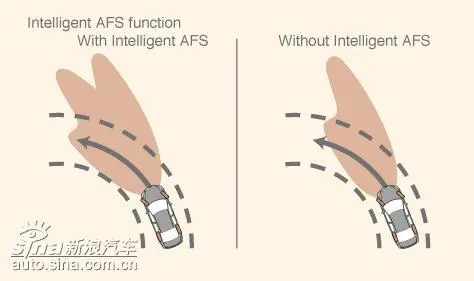

![](http://u.dianyuan.com/bbs/u/43/1152089049.jpg?x-oss-process=image/format,webp)
500) {this.resized=true; this.width=500; this.alt='这是一张缩略图,点击可放大。\n按住CTRL,滚动鼠标滚轮可自由缩放';this.style.cursor='hand'}" onclick="if(!this.resized) {return true;} else {window.open('http://u.dianyuan.com/bbs/u/43/1152089049.jpg');}" onmousewheel="return imgzoom(this);">
图片左侧为装有AFS主动转向大灯的车辆右侧为未启动该系统的车辆
